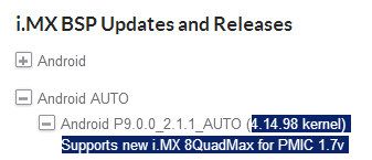

seems you are using very old L4.9.51-beta2 release which has not full i.MX8QM support.
Recommended to use latest L4,14,98 sumo with latest patches from i.MX Software | NXP
linux-imx - i.MX Linux kernel
Linux L4.14.98_2.0.0 Documentation
igor

seems you are using old i.MX8QM revision which was supported only on
early linux releases. Suggest to use latest silicon revision which is supported
by sumo.
i.MX Software | NXP
igor
