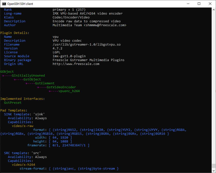

I would like to know what the kernel version is in your reference, as it pertains to unlocking the resolution limit for the VPU H264 encoder.
In my kernel version 5.15.71, there appears to be a resolution limitation within the GStreamer software.
Furthermore, when it comes to the VPU decoder, I am encountering difficulties in decoding H264 image from my camera at a resolution of 3840x2160 into raw video format. The gstreamer program displays an error message stating "Internal data stream error."

gst-launch-1.0 -e -v v4l2src device=/dev/video0 ! video/x-h264,width=3840,height=2160 ! queue ! vpudec ! appsink
