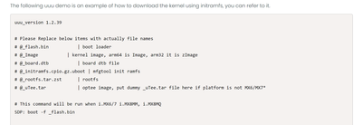

Zhiming_Liu
The following uuu demo is an example of how to download the kernel using initramfs, you can refer to it.

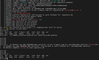

msivanesancq
Hi Zhiming
Thank you for the reply.
We executed all of the command that you were suggested in the iMX8MP dev board and we see device boots but not prompting for user login. Thus we think that rootfs is not loaded and mounted by the device. Please see the attachment for the kernel console output.
It would be helpful if you can advice us on which steps are need to be corrected.
Thank you
Mayuran

Zhiming_Liu
From the log, it seem that you want to transfer files after image boot. Please refer the uuu script. You may need to wait emmc device.
FB: acmd ${kboot} ${loadaddr} ${initrd_addr} ${fdt_addr}
# get mmc dev number from kernel command line
# Wait for emmc
FBK: ucmd while [ ! -e /dev/mmcblk*boot0 ]; do sleep 1; echo "wait for /dev/mmcblk*boot* appear"; done;
Zhiming

Zhiming_Liu
I am testing with fsl-image-mfgtool-initramfs-imx_mfgtools.cpio.zst.u-boot from https://github.com/Freescale/meta-freescale/blob/master/classes/mfgtool-initramfs-image.bbclass and it can boot into rootfs
uuu_version 1.2.39
# This command will be run when i.MX6/7 i.MX8MM, i.MX8MQ
SDP: boot -f imx-boot-imx8mp-lpddr4-evk-sd.bin-flash_evk
# This command will be run when ROM support stream mode
# i.MX8QXP, i.MX8QM
SDPS: boot -f imx-boot-imx8mp-lpddr4-evk-sd.bin-flash_evk
# These commands will be run when use SPL and will be skipped if no spl
# SDPU will be deprecated. please use SDPV instead of SDPU
SDPU: delay 1000
SDPU: write -f imx-boot-imx8mp-lpddr4-evk-sd.bin-flash_evk -offset 0x57c00
SDPU: jump
# if (SPL support SDPV)
SDPV: delay 1000
SDPV: write -f imx-boot-imx8mp-lpddr4-evk-sd.bin-flash_evk -skipspl
SDPV: jump
FB: ucmd setenv fastboot_dev mmc
FB: ucmd setenv mmcdev ${emmc_dev}
FB: flash bootloader imx-boot-imx8mp-lpddr4-evk-sd.bin-flash_evk
FB: ucmd if env exists emmc_ack; then ; else setenv emmc_ack 0; fi;
FB: ucmd setenv emmc_cmd mmc partconf ${emmc_dev} ${emmc_ack} 1 0
FB: ucmd if test "${emmc_skip_fb}" != "yes"; then run emmc_cmd; fi
FB: ucmd setenv emmc_cmd mmc bootbus ${emmc_dev} 2 0 1;
FB: ucmd setenv fastboot_buffer ${loadaddr}
FB: download -f Image
FB: ucmd setenv fastboot_buffer ${fdt_addr}
FB: download -f imx8mp-evk.dtb
FB: ucmd setenv fastboot_buffer ${initrd_addr}
FB: download -f fsl-image-mfgtool-initramfs-imx_mfgtools.cpio.zst.u-boot
FB: ucmd setenv bootargs console=${console},${baudrate} earlycon=${earlycon},${baudrate} root=/dev/ram rw
FB: DONE
