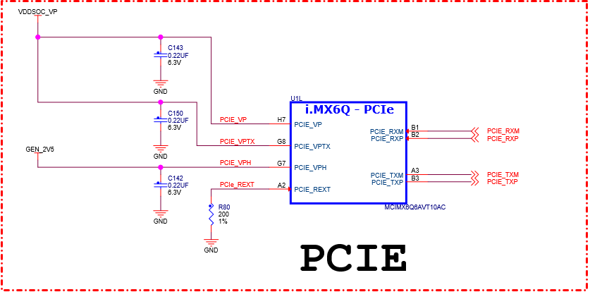

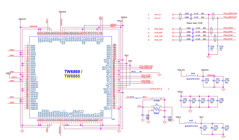

我们采用imx6s+TW6865接收摄像头视频输入,linux内核是3.0.35。在驱动移植中遇到一些问题,不知道各位是否有遇到类似问题。
1:imx6s+TW6865通过pcie连接,原理图如下(6S和6Q pin2pin)。硬件工程师说pcie时钟信号正常。

From your png image, the card was not dectected. Please try this change, if still not work please compare the hardware signals with 6dq which can work(power/clk/reset pin):
