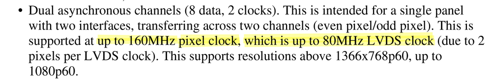

When trying to setup the parameters for a custom LVDS display on the IMX8MP native LVDS (ldb) interface, we noticed that it's not possible to achieve the needed 60MHz Pixel Clock:

The code that I showed above is from linux 5.4 but I already checked on 5.15 and the check for the pixel clocks is still there.
Considering this, I would like to ask:
What is the reason for this limitation? It seems that the hardware supports other options than 75Mhz or 150Mhz and this is also stated in the Reference manual:
Thank you in advance for the help,
Rafael

the reason I think already post in the code already, because limited video PLL frequency points on i.MX8mp, so not all of lvds clock can be supported, if can be supported, just remove the code as you did though the code uses fixed clock as default

I would expect the driver code to be fixed by NXP. The current driver just set a fixed clock value while the hardware limitation is on the maximum one, to me this is just a bug. Am I misunderstanding something?

this clock is from PLL is fixed in the current bsp, if customer use different clock, they need to change the PLL source from the clock driver source code, and couldn't support any clock customer wants
https://source.codeaurora.org/external/imx/linux-imx/tree/drivers/clk/imx/clk-pll14xx.c?h=lf-5.10.y
static const struct imx_pll14xx_rate_table imx_pll1443x_tbl[] = {
PLL_1443X_RATE(1039500000U, 173, 2, 1, 16384),
PLL_1443X_RATE(650000000U, 325, 3, 2, 0),
PLL_1443X_RATE(594000000U, 198, 2, 2, 0),
PLL_1443X_RATE(519750000U, 173, 2, 2, 16384),
PLL_1443X_RATE(393216000U, 262, 2, 3, 9437),
PLL_1443X_RATE(361267200U, 361, 3, 3, 17511),
customer wants to support clock besides of 74.25 and can source from imx_pll1443x_tbl, they just comment the code which fixed the clock to avoid unsupported mode
