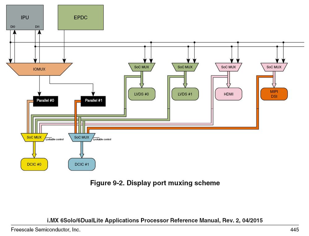

I am working on connecting an LVDS to my project, with no success as of yet. I am a bit lost when it comes to the crtc field in the device tree.
I am working off kernel 3.14.79
I have modified the hummingboard2 device tree's entry for ldb to suit the timings of my display, to look like this:
/* old mxcfb1 setting for HDMI - POSTED here for clarity */
mxcfb1: fb@0 {
      compatible = "fsl,mxc_sdc_fb";
      disp_dev = "hdmi";
      interface_pix_fmt = "RGB24";
      mode_str ="1920x1080M@60";
      default_bpp = <32>;
      int_clk = <0>;
      late_init = <0>;
      status = "okay";
/* new fb1 setting for LVDS */
&mxcfb1 {
      disp_dev = "ldb";
      interface_pix_fmt = "RGB666";
      default_bpp = <16>;
      int_clk = <0>;
      late_init = <0>;
      mode_str ="1280x720M@60";
      status = "okay";
&ldb {
           status = "okay";
           lvds-channel@0 {
                crtc = "ipu1-di0";   // ipu2-di0  has errors in dmesg on boot
                /* Ive observed the following properties in other posts, which I assume
                 * are specific to splitting the LVDS due to larger displays and the limitations of the clock
                 * but I am unsure if its necessary for a singular display */
                ipu_id = <0>;
                disp_id = <1>;
                ext_ref = <1>;
                mode = "sin0";
                sec_ipu_id = <0>;
                sec_disp_id = <0>;
                status = "okay";
                display-timings {
                          native-mode = <&timing0>;
                          /* overwrite timings for Tianma TM070JDHG30 */
                          timing0: hsd100pxn1 {
                                     clock-frequency = <75210590>;
                                     hactive = <1280>;
                                     vactive = <720>;
                                     hback-porch = <5>;
                                     hfront-porch = <64>;
                                     vback-porch = <2>;
                                     vfront-porch = <40>;
                                     hsync-len = <69>;
                                     hsync-len = <69>;
                                     vsync-len = <42>;
                            }; // ~timing0
                }; // ~display-timings
        }; //~lvds-channel@0
}; // ~ldb
I've read that the crtc is supposed to point to the IPU device to connect the LVDS to, but I cannot find any documentation on this property, and/or what other supporting nodes need to be configured for this to work.
as i mentioned in the comment ipu2_di0 provides errors in dmesg (invalid or unspecified crtc), but ipu1_di0 seems to run okay in the dmesg:
[ 0.414411] mxc_sdc_fb fb.32: registered mxc display driver ldb IPU1_DISP0
[ 0.414424] mxc_sdc_fb fb.32: registered mxc display driver ldb
To summarize :
I can't get my LVDS working, and at this point everything I try is a shot in the dark, so my basic questions are:
1) What value should I be putting for the crtc property?
2) What other supporting (device tree or other) configurations are needed to support the crtc property?
3) How does this magically link to a frame buffer? Thus far I've been catting' to the frame buffers to see if theres any changes on my displays, but have yet to have any luck.
Thanks in advance

For a sense of completion, I was able to get it working!
My problem was a hardware problem. After that was solved and a slight timing adjustment, using boundary device's timing for the Tianma (I'm using the same display, but not their Boundary U-Boot). For those struggling, here is my device tree node:

igorpadykov
Hi Dan
what processor used in the case, as i.MX6DL has only one IPU,
while i.MX6Q - two. For crtc one can look at ldb driver in
linux/drivers/video/fbdev/mxc/ldb.c and description in attached Linux Manual.
igor

igorpadykov Its an i.MXDL. I have discovered there were hardware issues. I am working to resolve those and then will revisit. In the meantime, it may be a silly question, but is it possible to use the same IPU to provide the same data to two displays simultaneously ? i.e. to HDMI and LVDS ?
EDIT:
nevermind. I see all variants support dual displays here.
