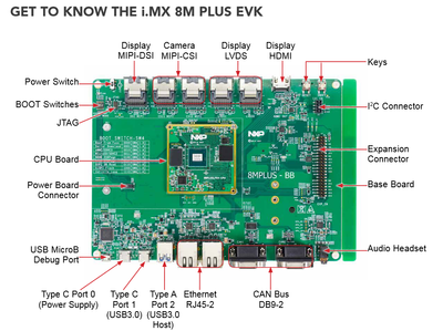

Does mipi-rx interface of imx8m plus support LVDS raw camera? The camera has a one-lane lvds output.

On the I.MX 8M Plus, below are the connectors available.  Which connector are you referring to?

I am using the Camera MIPI-CSI connector. I have successfully driven a two-lane mipi sensor with this connector, but my new sensor only has one-lane LVDS output, and I wonder whether I can directly connect this LVDS sensor to the CSI connector.

Please clarify what you mean by "you have successfully driven a two-lane mipi sensor with this connector?" Which connector are you referring to here?
I assume you would need some bridge to convert LVD to MIPI or serializer to de-serializer converter.
