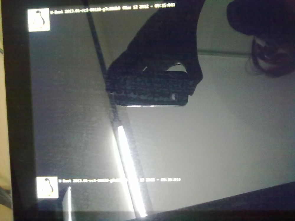

I am trying to interface 1024RGB×768  LVDS display over LVDS0 interface on i.MX6, i am able to see the u-boot logo on the display but it is as shown below :
--> Linux kernel is 3.0.35 and the boot arguments are as below :
setenv bootargs console=ttymxc0,115200 init=/init rw video=mxcfb0:dev=ldb,LDB-XGA

fabio_estevam
Is this a custom board and LVDS panel? Looks like you need to adjust its timings in U-boot.
Check the displays struct in:
board/freescale/mx6qsabrelite/mx6qsabrelite.c

soujanyak
Thanks Estevam...
              In u-boot i have adjusted the display timings and now i am able to boot my 1024X768 LVDS display (RGB666).
