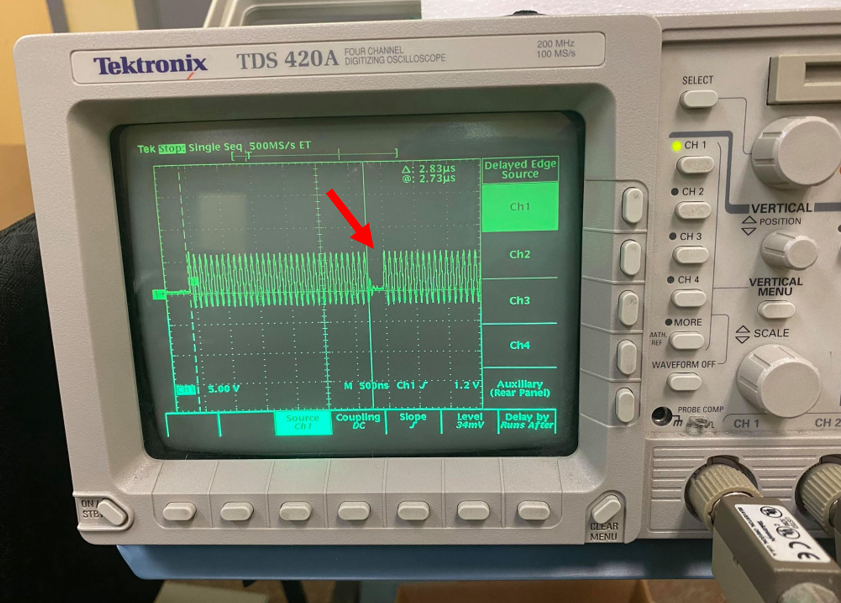

I am working on a custom board based off the MIMXRT1050-EVK demo board using Keilv5 Pro edition. I am currently testing the LPSPI with EDMA and am following the example projects.
My issue is that the LPSPI EDMA is too slow for my project to function correctly. I need to transfer 1280 bits of data using the EDMA to LPSPI transmit buffer at 13Mhz in under 100us. Right now, it is taking about 124us according to my read out.
I set a probe on the LPSPI clock and I notice there is a 300ns delay between every 32 bits sent, shown in the picture below. Why is there a delay every 32 bits? Is there any way I can remove the delay or speed up the EDMA or LPSPI without changing the LPSPI clock frequency?
The function I am using to make the EDMA transfer to LPSPI is LPSPI_MasterTransferEDMA(). In this function is a bunch of LPSPI API calls and configuration. I am currently testing adjusting this function to increase the speed of the transfer or remove the delay between the 32 bits.
I also have another issue where the LPSPI_MasterTransferEDMA() function does not start sending data right way. I am calling this function within an interrupt, it then takes 18us to begin transferring data while still in that same interrupt. I need it to begin immediately. Is there a flag or something that needs to be set to start the EDMA transfer?
My questions:
  1. Why is there a delay after every 32 bits sent through the LPSPI? Can that be removed?
  2. Why is the EDMA LPSPI transfer not beginning right away?

1) Why is there a delay after every 32 bits sent through the LPSPI? Can that be removed?
-- Whether you mean that there's a stalled period during transmitting the whole 64 bytes, maybe you can try to increase the txWatermark since transfers will stall when transmit FIFO is empty or receive FIFO is full.
2) Why is the EDMA LPSPI transfer not beginning right away?
-- It needs the developer to optimize and simplify the code by himself.

kamal1
@jeremyzhou
I have that working now the issue I am having is that if I send in write data too fast I dont see the correct data on the output SPI device. If I include a delay of 3 microseconds after each write or wait for the tx fifo to empty, I do get the correct data. My application does not have enough time to include these delays, how can I avoid them?
I think this delay is needed to account for the stall when the tx fifo gets full. The LPSPI_CFGR1_NOSTALL_MASK is cleared which means Transfers will stall when the transmit FIFO is empty or the receive FIFO is full. Whye is the TX fifo ever getting full? Even after setting the tx watermark to 0, I still have the same issue.
How can I get the LPSPI to transmit data immediately without needing a delay?

jeremyzhou
Thanks for your reply.
1) How can I get the LPSPI to transmit data immediately without needing a delay?
-- 1) The steps of modifying the lpspi_edma_b2b_transfer_master demo (SDK library version is 2.8.5)
a) in lpspi_edma_b2b_transfer_master.c, increae the number of tranmit data and transfer baudrate.
#define TRANSFER_SIZE 160U //64U /* Transfer dataSize */
#define TRANSFER_BAUDRATE 15000000U /* Transfer baudrate - 15M */
b) in the LPSPI_MasterGetDefaultConfig() function in the fsl_lpspi.c,
increase the baudRate and bits of per frame, meanwhile, decrease the delay value, below illustrates the modified LPSPI_MasterGetDefaultConfig() function.
void LPSPI_MasterGetDefaultConfig(lpspi_master_config_t *masterConfig)
    assert(masterConfig != NULL);
    /* Initializes the configure structure to zero. */
    (void)memset(masterConfig, 0, sizeof(*masterConfig));
    masterConfig->baudRate     = 15000000;
    masterConfig->bitsPerFrame = 32; //8;
    masterConfig->cpol         = kLPSPI_ClockPolarityActiveHigh;
    masterConfig->cpha         = kLPSPI_ClockPhaseFirstEdge;
    masterConfig->direction    = kLPSPI_MsbFirst;
    masterConfig->pcsToSckDelayInNanoSec        = 1000000000U / masterConfig->baudRate;//masterConfig->baudRate * 2U;
    masterConfig->lastSckToPcsDelayInNanoSec    = 1000000000U / masterConfig->baudRate;//masterConfig->baudRate * 2U;
    masterConfig->betweenTransferDelayInNanoSec = 1000000000U / masterConfig->baudRate;//masterConfig->baudRate * 2U;
    masterConfig->whichPcs           = kLPSPI_Pcs0;
    masterConfig->pcsActiveHighOrLow = kLPSPI_PcsActiveLow;
    masterConfig->pinCfg        = kLPSPI_SdiInSdoOut;
    masterConfig->dataOutConfig = kLpspiDataOutRetained;
2) Testing result
After the above modification, the SPI can transfer 160 bytes in 86.3 us which only takes about 1 us longer than the none-delay condition (as Fig 1 shows). And the interval time between per frame is 56 ns (as Fig 2 shows).
In a word, the transmit speed is enough fast for your requirement.
Note: The testing platform is MIMXRT1050.
