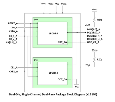

Hi everyone,
We are trying to design a custom board based on the i.MX 8M Nano LPDDR4 EVK. The DRAM part number used in the EVK reference design (C1612PM1WDGTK-U) and the alternative (C1612PC2WDGTKR-U) are both obsolete. Has anyone been able to successfully use another 16Gbit LPDDR4 DRAM with this SoC?

What are your thoughts on Kingston D1611PM3BDGUI-U. It is very similar to C1612PM1WDGTK-U which is used on the EVK except that the configuration is 128Mb x 1 rank(s) x 8 banks x 16 DQ x 1 channel instead of 64Mb x 2 rank(s) x 8 banks x 16 DQ x 1 channel. Below is the block diagrams of the proposed single rank DRAM and the obsolete dual-rank DRAM:
I could use a similar routing, except I would disconnect CS1_A, CKE1_A and ZQ1. Or I could keep them connected in case I want to drop in a dual rank configuration in the future. Please let me know what you think.

Hello @farid_msvi
Please check this post, this is about of tested memories in i.MX8M family, unfortunately all the tested memories are obsolete or end of life, but also there is a list of incompatible memories that you should avoid.
Salas.
