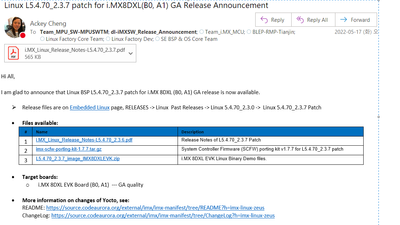

it seems that L5.4.70_2.3.7 BSP isn't the GA version, I checked the bb file in my 5.15 bsp source code, I don't find this, refer to the L5.4.70_2.3.2 release note, this bsp supports i.MX 8DXL EVK Board (Proto1B with A1 only), and for building 8dxl board, customer needs to use "mx8dxlevk" as machine name, refer to your description, $(IS_DXL) stands for  IS_DXL , not for IS_DXL_mx8dxl , and  IS_DXL is fault and IS_DXL_mx8dxl is true

This is GA version for i.MX8DXL B0
And from below source folder, and i used imx8dxlb0-lpddr4-evk for MACHINE name.
IS_DXL is false , and IS_DXL_mx8dxl is true as you see my captured file. but i could see the log. So, I created how this is occurred on yocto BSP.
