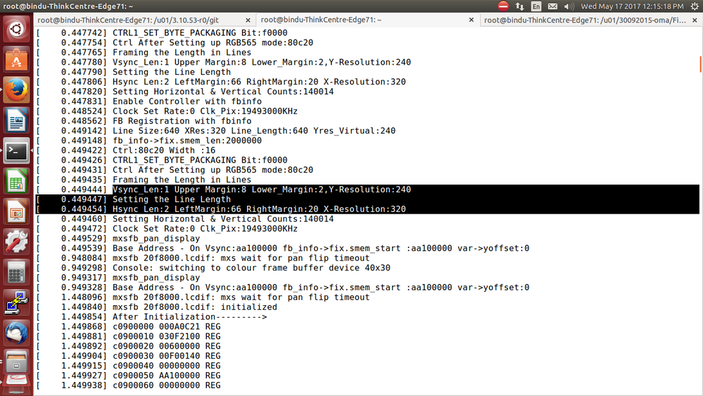

Dear Team,
         we are currrently migrating form 3.0.35 kernel on 3.10.53  kernel for our i.mx6sololite custom board .we have been facing LCD configuring issues with 3.10.53 kernel . the file named mxc_elcdif.c is not there in new kernel ,it is the main file for configuring custom LCD.we have modified the dtb file but the values are not reflecting for LCD.can you people help us which are the main files to be modified for configuring LCD display clearly.please do respond ASAP.

Hi chandana
for eLCDIF driver location please refer to sect.12.5 Source Code Structure
attached Linux Manual. Also please modify new timings in imx6sl-evk.dts
&lcdif{..
display-timings..
linux-imx.git - i.MX Linux Kernel

hi igor,
We already placed the changes i.e display timings in imx6sl-evk.dts that values are not passing to mxsfb.c file .that file is taking default values and its not been changed .our's is 340*220 resolution LCD screen and the same is showing in X-resolution and Y-resolution variables,Even though it is same the logo is not clear and it is striped.kindlly help us to resolve the issue.For ur reference am attaching the screen shotDisplay_Values.png

HI SALVA,
Your issue is solved, if not Please check the clock frequency and do you have initialization code for the LCD, if there please check the correct data and command for LCD,
