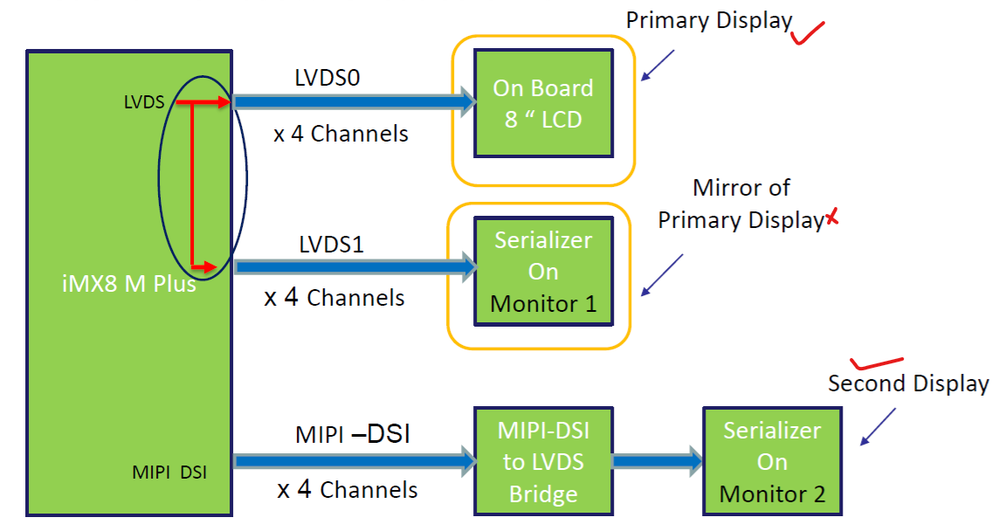

I have an imx8mp based custom board.
I'm trying jailhouse hypervisor in it. I followed IMXVIRTUG_ga and I'm able to run a Linux demo in jailhouse inmates. now I want to bring up one LCD to the inmate.
Here I would like to use the second display in inmate Linux. So I disabled the LCDIF1 (second display) and the  i2c3 (where touch screen controller is connected) in root cell dtb and enabled them in the im8mp-evk-inmate.dts file (i have attached the inmate DTS file)

I can see that the LCDIF and MIPI_DSI  nodes are populated at /sys/devices/platform/soc@0/32c00000.bus/
root@imx8-inmate:~# ls  /sys/devices/platform/soc@0/32c00000.bus/
32e60000.mipi_dsi  32e80000.lcd-controller  32ec0000.blk-ctl  consumers  driver_override  modalias  of_node  power  subsystem  suppliers  uevent
any idea why this is happening?
am I missing anything in inmate.cell (attached .c inmate config file) configuration or any clock or pin config in inmate.dtb file ?
