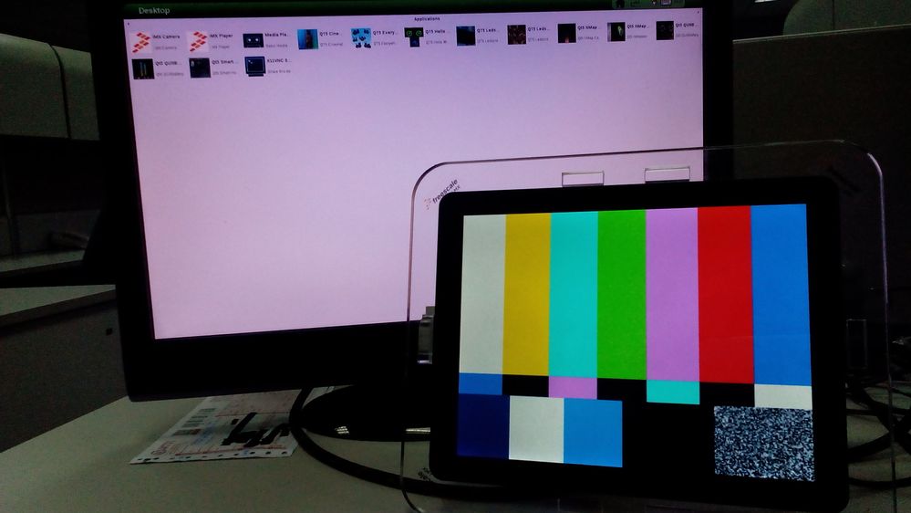

BiyongSUN
What is "LCD and HDMI interface not working together ! "?
we have tried and lots of customers tried. They are working fine.
could you please run the following command to see if the lcd is showing the UI and hdmi is playing gstream test.
gst-launch-1.0 videotestsrc  ! imxv4l2sink  device=/dev/video18
also you can modify the /etc/X11/xorg.conf
to see if the UI is changed to hdmi.
Section "Device"
    Identifier  "i.MX Accelerated Framebuffer Device"
    Driver      "vivante"
    Option      "fbdev"     "/dev/fb2"
    Option      "vivante_fbdev" "/dev/fb2"
    Option      "HWcursor"  "false"
EndSection
The driver layer is enabled.
It is not Android, has already implemented showing the UI both on the dual display.
You need to implement that.
this my test:
root@imx6qdlsolo:~# cat /proc/cmdline
console=ttymxc0,115200 root=/dev/mmcblk2p2 rootwait rw video=mxcfb0:dev=ldb video=mxcfb1:dev=hdmi,1920x1080M@60,if=RGB24
