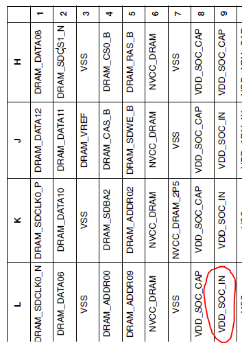

Hello Community
About L9 pin of i.MX6SoloX(17x17 mm NP),the information in Table 122 and Table 124 of datasheet IMX6SXAEC
is different.I want to know which is right.
1)In Table 122. 17x17 mm NP (no PCIe) supplies contact assignments (continued)
2)In Table 124. 17x17 mm (No PCIe), 0.8 mm Pitch, 20x20 Ball Map (continued)
3)Besides,in Table131(i.MX 6SoloX Data Sheet Document RevisionHistory,there is note as below:
• In Table 122, "17x17 mm NP (no PCIe) supplies contactassignments," on page 168, added ball L9 to the VDD_SOC_CAP row
Please tell me which is right.

Dear ZongbiaoLiao,
Table 124 is correct. The pin L9 should be VDD_SOC_IN.
This can be confirmed by Processor Expert,
<Processor Expert for i.MX|Freescale >
Yongxin
