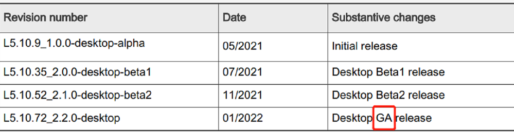

juan_tang
HI,@nxf65025
I tested the four versions in the figure below, only L5.10.9_1.0.0-desktop-alpha did not have the problem. But  all customers used GA release of BSP not alpha&beta release of BSP,I really hope to have a patch fix as soon as possible。Many thanks!微信图片_20220406105248.png
