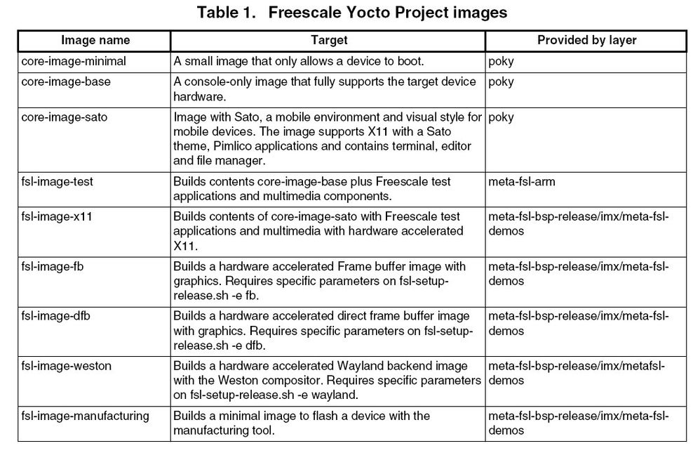

Below officially supported (tested by Freescale) images (from Freescale_Yocto_Project_User's_Guide.pdf L3.10.17_1.0.0_LINUX_DOCS  )
seems core-image-rt supported by community and I would highly recommend to try
latest (dizzy)
FSL Community BSP Release Notes 1.7 documentation
Also I would recommend to post this to meta-fsl-arm mailing list, so that someone familiar with core-image-rt could try to assist you.
