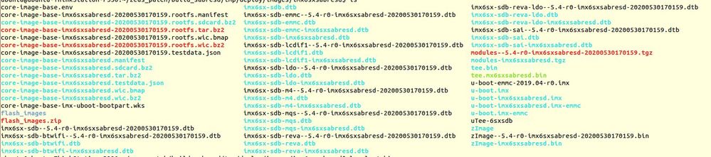

nikhil_sahu2
Hi @Aldo,
Thanks for the reply, I want to flash using linux kernel method. But i dont have all the images which required to modify as per the script.
# @_flash.bin                        | boot loader  (No, but can we use u-boot.imx here?)
# @_Image                        | kernel image, arm64 is Image, arm32 it is zImage (yes)
# @_board.dtb                        | board dtb file (yes)
# @_initramfs.cpio.gz.uboot        | mfgtool init ramfs (No)
# @_rootfs.tar.bz2                | rootfs (Yes)
# @_uTee.tar                        | optee image (No)
I compiled the image (bitbake core-image-base) and the generated binaries i attached in screenshot.Capture_image.JPG
Please let us know, how we can achieve all the mentioned image as per the script.
Nikhil

AldoG
Can we use u-boot.imx here?
Yes no problem
Please try with the attached file
optee image (No)
Please try to comment line 82 and 83 from script.
Hope this helps,
Aldo.

AldoG
I made some changes to the file you have attached, I also notice that in my previous comment didn’t attach the file you were missing please find it here as well.
Note: you may find fsl-image-mfgtool-initramfs-imx_mfgtools.cpio.gz.u-boot inside our pre-compiled BSP that’s where I took it from:
https://www.nxp.com/webapp/Download?colCode=L5.4.3_1.0.0_MX6QDLSOLOX&appType=license
Changes I made on your script:
u-boot-imx6sxsabresd.imx -> u-boot-imx6sxsabresd.imx-emmc
_initramfs.cpio.gz.uboot -> fsl-image-mfgtool-initramfs-imx_mfgtools.cpio.gz.u-boot
Please add those 2 files and try it, let me know if it worked.
