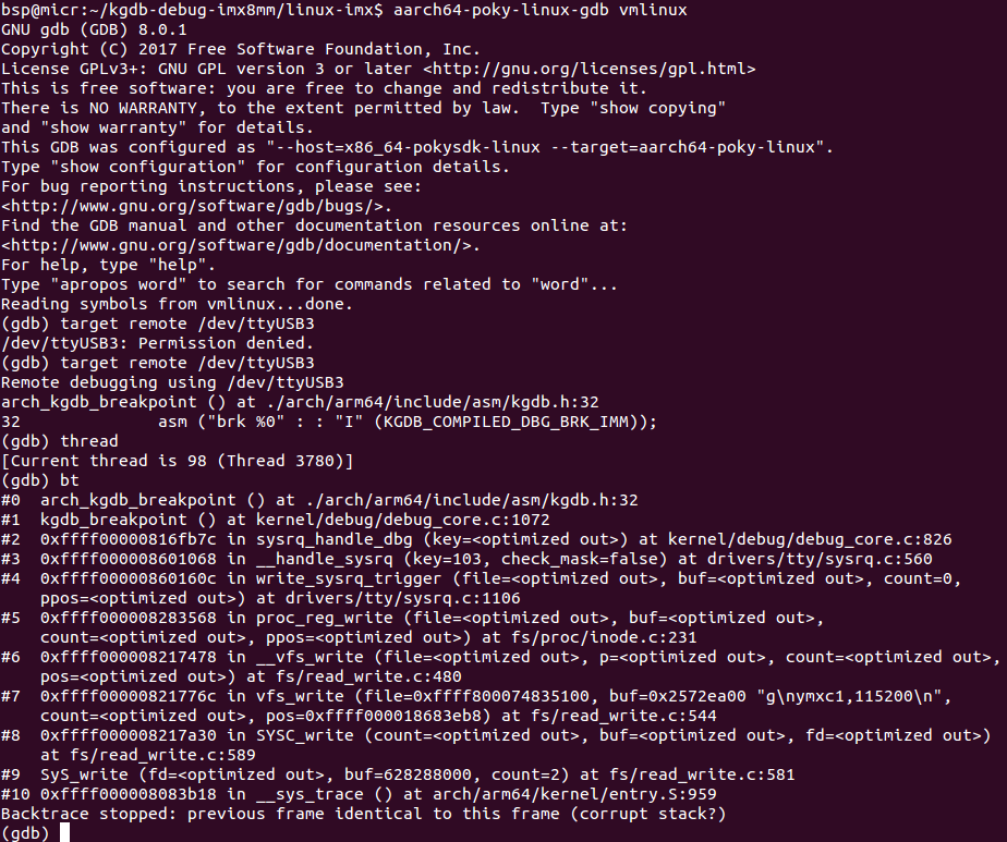

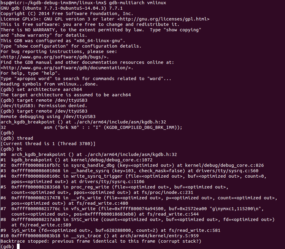

Hi Lorenzo,
Connecting the debugger can work in my side, as follows:
For gdb-multiarch, customer need to "set architecture aarch64" firstly,then "target remote /dev/ttyUSBx".
Another method:
If you want to extending the terminals, they can use agent-proxy. The steps is as follows:
in another terminal:
Then in the third terminal, executing "gdb-multiarch vmlinux" or "aarch64-poky-linux-gdb vmlinux"  to connect target.
Note the last picture, "target remote localhost:5551" when connecting target.
Israel H.
