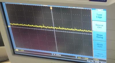

We have been working on i.mx8mplus EVK while debugging getting an failed to connect to the target error. while debugging we observed on each and every pin of JTAG in oscilloscope then we found that TDO pin is 0.5v continuously. Do this create any issue?
             IDLE                   Debugging
VTRF: 1.8V(high)              1.8V(high)
TMS: 0V(low)                  high low(changing)
TCK: 0V(low)                  depends on CLK values
TDI: 1.8V(high)                data
TDO: 0.5V                        0.5V
Reset: 1.8V(high)           1.8V(high)

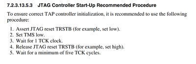

According to the reference manual, the recommended procedure to start the JTAG controller is:
Also, you can try to follow the AN14367 (Debugging Cortex-A U-Boot and Native RTOS on i.MX 8M Plus and i.MX 93 EVKs).

we have observed the data is going on TDI and clock on TCK pin but no data is observed on TDO. The TDO pin is continuously low.
1. Why we are unable to connect the board in remote debug?
2. Do we need to enable any other pin in hardware?
3. what is the register should i read for jtag is enabled or disabled ?
4. we have worked on jtag debugging with remote debug and without debug(it means with JTAG Probe) , in both cases TDO is not responding correctly (data is not transfaring).
What should be the reasons for TDO behaving like that?
