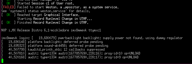

I am experiencing several issues while using the NXP i.MX 8M Mini (8MMINILPD4-EVKB) Evaluation Board. On boot, I observe the following error messages:
[FAILED] Failed to start Weston, a compositor, as a system service.pwm-backlight backlight: supply power not found, using dummy regulator
platform backlight: deferred probe pending
platform sound-ak4458: deferred probe pending
please provide solutions to resolve these errors.

  1. What could be the reason for the backlight supply power error? Is there a way to configure the correct regulator?
  2. How can I troubleshoot the sound card issue?
  3. What are the common causes for Weston service failures, and how can I resolve them?
I would appreciate any guidance or recommendations on how to fix these issues.

If you are using the EVK you don't have to fight with this issue, for that burn a new image of the latest BSP, and tested, if the issue persist you have a damaged board.
