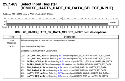

It looks like something is wrong with you external connection between your Bluetooth module in the RX pin of the UART.
4,389 Views
ekerebel
@ceggers Thank you for the response.
I think my registers are correct.
here is imx6sll_pinfunc.h:
#define MX6SLL_PAD_ECSPI1_MOSI__UART5_DTE_RX                      0x01B0 0x0478 0x0764 0x2 0x3
 And an extract from memtool:
Reading 0x1 count starting at address 0x020E0764
0x020E0764:  00000003
My RX is on R131 of the EVK (ECSPI1_MOSI).

ceggers
Contributor V
Maybe this problem is related to pin muxing. The RX signal of UART5 can be taken from several sources. You may want to check the appropriate register setting (see picture).
regards
