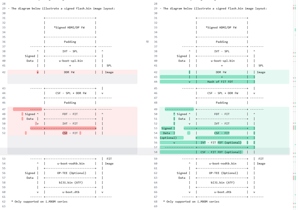

I checked those changes.
I applied patches as described here for integrating them in uboot-imx and imx-mkimage repositories.
I think I can say the FDT-FIT hash solution with (optional) FDT-FIT signature works as expected, since I am seeing this logs at the very first stage of u-boot command prompt console:

So, there must be some other relevant changes between 2022 and 2023 versions that need to be applied for having the HAB feature working.
Could you please provide a much detailed solution as I need to apply ad-hoc changes in order to have HAB feature works with the 2022.04 U-Boot version?
