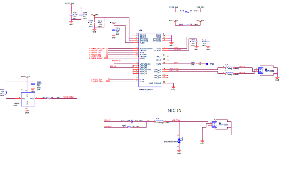

Below is the snapshot from the schematic for hardware connections.
Codec is connected on I2C1 and SAI2.
Below are my changes in the device tree.
There is no headphone in custom board. Playback device is speaker and Capture device is MIC. both are always there , there is no jack for mic detect.
I have made related changes in device tree like pin muxing, i2c change and sai2.
But neither playback nor capture are working.
When i try to play using aplay, It gives me below error.
aplay: pcm_write:1947: write error: Input/output error       <== ERROR
Codec is getting detected in i2c bus, I have tested it through i2cdetect utility.

Hi jagdish
one can check mclk signal with oscilloscope and disable ECSPI3 as
its signals shared with sai2, please refer to imx7d-sdb.dts
linux-2.6-imx.git - Freescale i.MX Linux Tree
igor

Below is my pinmux for SAI2 interface in device tree.
pinctrl_sai2: sai2grp {
            fsl,pins = <
                MX7D_PAD_SD2_RESET_B__SAI2_MCLK           0x1f
                MX7D_PAD_SAI2_TX_BCLK__SAI2_TX_BCLK     0x1f
                MX7D_PAD_SAI2_TX_SYNC__SAI2_TX_SYNC     0x1f
                MX7D_PAD_SAI2_TX_DATA__SAI2_TX_DATA0    0x30
                MX7D_PAD_SAI2_RX_DATA__SAI2_RX_DATA0    0x1f
Is it proper?
I am getting 12MHz from the processor mclk pin when i try to run aplay command. Is it a proper behaviour?
