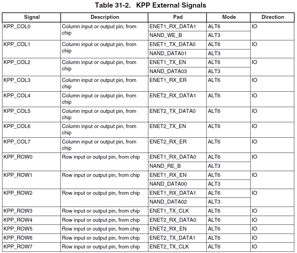

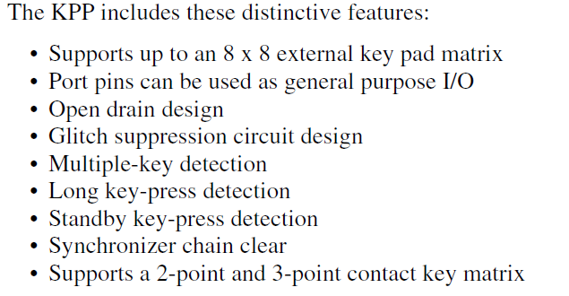

Dear Bruce,
   I.MX6UL supports 8x8 hardware keypad port :
So why not use existing hardware interfaces and combine KEYPAD with GPIO?
About your questions:
1. No issues were found in your device tree.
2. I feel pinctrl_keypad_row & pinctrl_keypad_col were not run.
So my suggestion is that we firstly ensure all GPIOs for KEYs can be multiplexed correctly, then configure their inputs and outputs.
Have a nice day!
NXP TIC Weidong
