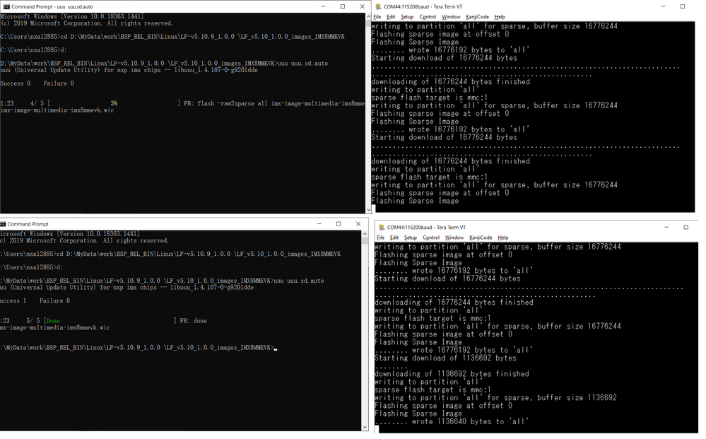

Here is the script to flash the sdcard. uuu uuu.sd.auto to use it.
uuu.sd.auto
uuu_version 1.2.39
# This command will be run when i.MX6/7 i.MX8MM, i.MX8MQ
SDP: boot -f imx-boot-imx8mmevk-sd.bin-flash_evk
# This command will be run when ROM support stream mode
# i.MX8QXP, i.MX8QM
SDPS: boot -f imx-boot-imx8mmevk-sd.bin-flash_evk
# These commands will be run when use SPL and will be skipped if no spl
# SDPU will be deprecated. please use SDPV instead of SDPU
SDPU: delay 1000
SDPU: write -f imx-boot-imx8mmevk-sd.bin-flash_evk -offset 0x57c00
SDPU: jump
# if (SPL support SDPV)
SDPV: delay 1000
SDPV: write -f imx-boot-imx8mmevk-sd.bin-flash_evk -skipspl
SDPV: jump
FB: ucmd setenv fastboot_dev mmc
FB: ucmd setenv mmcdev ${emmc_sd}
FB: ucmd mmc dev ${emmc_sd}
FB: flash -raw2sparse all imx-image-multimedia-imx8mmevk.wic
FB: done
