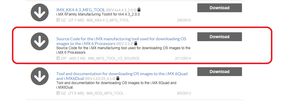

igorpadykov
Hi Colin
MFG Tool source codes are available at
Programmers (Flash, etc.) (12)
Source Code for the i.MX manufacturing tool used for downloading OS images to the i.MX 6 Processors (REV 2.3.2)
http://www.nxp.com/products/microcontrollers-and-processors/arm-processors/i.mx-applications-process...
igor

igorpadykov
Hi Atis
source code can be found on
i.MX 6Quad Applications Processors | Quad Arm® Cortex®-A9 | NXP
igor

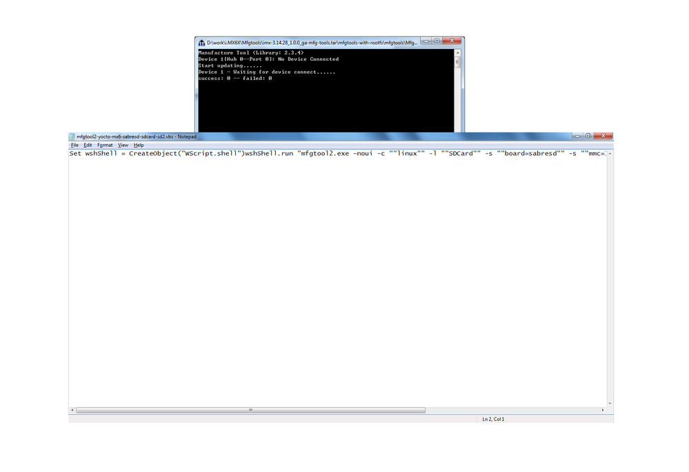

BiyongSUN
Have you even tired the command line of the mfg tool in Igor's reply before you say "without the need to click the start button" .
Did you follow Igor's guide and try to look the behavior of the mfg tool command line.
Here is the screenshot, you don't need to click any button.
The souce code is on the website

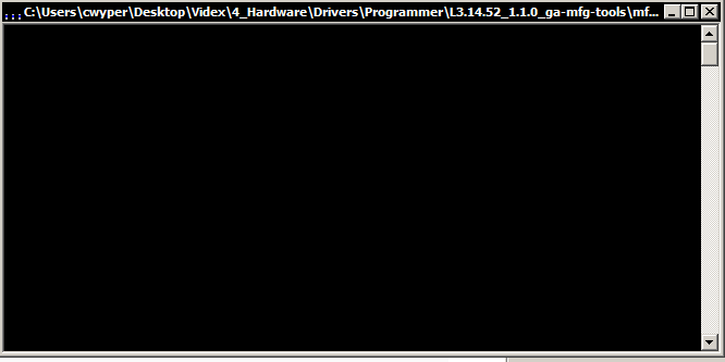

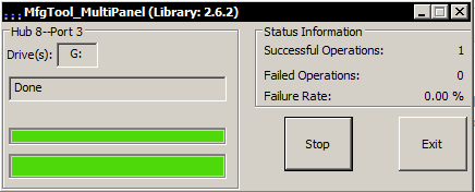

colinwyper
Hi there,
I have tried but it doesnt appear to do much on mines. Not sure if ive done something wrong but i just get a blank screen when i launch mines.
So i've created a script for the board i am looking to program. When i run it normally i get the following window
When i click start it runs and works so i know the script i've created is working
However when i add in -noui i get the following:
Sometimes it closes and sometimes it just stays open. Doesn't really give any indication as to whether its worked or not.
This is the code from the .vbs:
Set wshShell = CreateObject("WScript.shell")
wshShell.run "mfgtool2.exe -noui -c ""linux"" -l ""NAND Flash""  -s ""board=sabreauto"" -s ""6uluboot=evk"" -s ""nand=nand"" -s ""6uldtb=14x14-evk"" -s ""nanddtb=gpmi-weim"" -s ""part_uboot=0"" -s ""part_kernel=1"" -s ""part_dtb=2"" -s ""part_rootfs=3""   "
Set wshShell = Nothing
How do i get mines to display like yours? Is there anyway for it to display the status like it does on the user interface? Even just messages of the status as it stands i don't know what state it is in.

BiyongSUN
You can try to run the command "mfgtool2.exe -noui" to test it in the windows command line window.
Or you can refer to the follow modification in vbs.

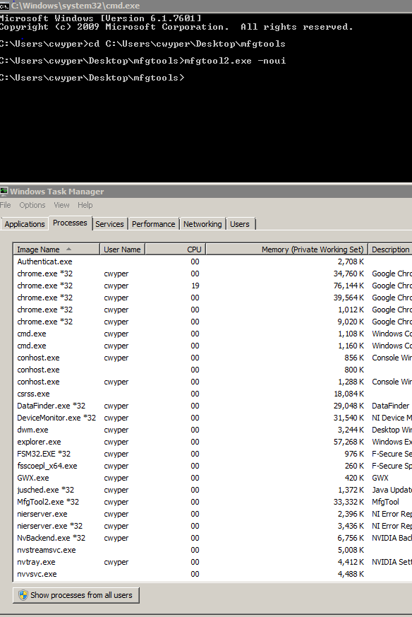

colinwyper
Hi there,
So i tried what you had asked but i don't get any window popping up. Please see the following:
So it runs in the processes, but it will just sit there and not do anything. am i doing something wrong?
4,610 Views
BiyongSUN
You didn't do anything wrong.
You need to change to another PC to try.
