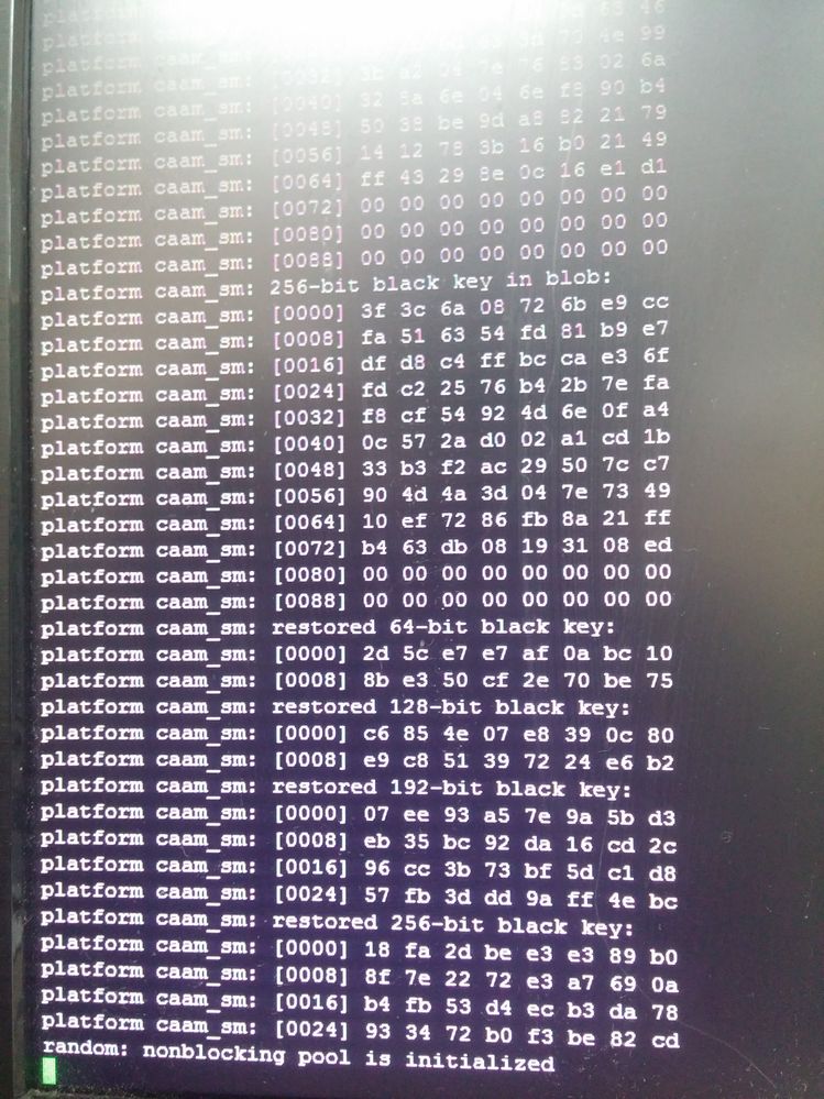

Nowadays I try to analyze 3.14.28 Kernel in IMX6DL.
by using J-TAG debugger, i'd like to repeat "break" and "continue" where i want.
It was successful on 3.10 Kernel.
But it always stopped whenever i tried to do.
Look at the following picture.
there is one weird thing. without J-TAG attached, it went through well by ramdisk.
Also, J-TAG debugging worked well before the message saying "random: nonblocking pool is initialized" when i tried to attach J-TAG.
But it didn't work after the message whenever i debugged by using J-TAG.

after "arch_hw_breakpoint_init", program never stopped even though i made break point.
I ran into this problem as well, building 4.9.9.  That function resets the hardware breakpoints that the JTAG is using, so after that function runs they are all gone and the debugger will miss them.  Stepping through that function you might notice that it interacts with the debugger using "mrc p14" (ARM Information Center).  Due to optimizations I couldn't figure out exactly what instruction was clearing the breakpoints.
You can disable that function by disabling CONFIG_PERF_EVENTS in `make menuconfig`, which uses the hardware breakpoints for performance monitoring.  That probably isn't necessary while you're debugging.
CONFIG_DEBUG_INFO=y and CONFIG_GDB_SCRIPTS=y are also useful during kernel debugging.
