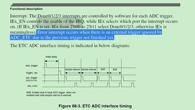

Hi team!
I'm using MIMXRT1170-EVK.
Is there any way to know the cause of ADC_ETC error interrupt?
I couldn't find error flags in ADC and ADC_ETC register.
Only I could see interrupt detected flags.

Hi @kenji
  About the ETC err, please check the RT1170 reference manual, you will find the ETC error reason:
So, your error is caused by the previous trigger is not finished.
Kerry

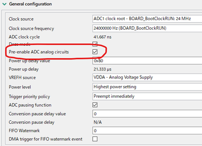

kenji
Hi @kerryzhou -san
I could solved, enabling this flag.
Thank you for the information.
