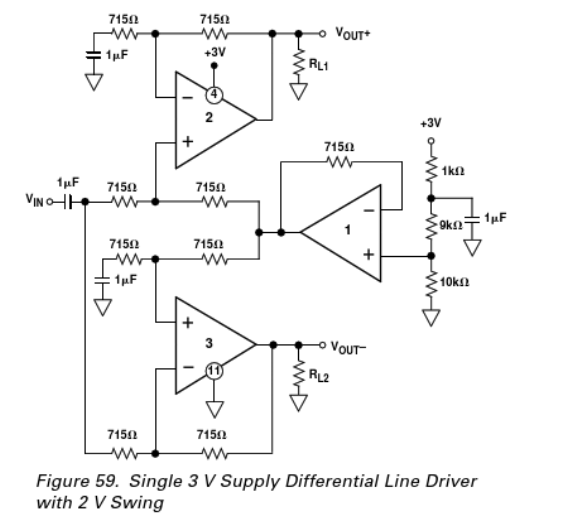

I use bt656 of imx6s to driver ADV7391 to output single-ended cvbs,but I want differential CVBS.
How can I to transform single-ended to differential CVBS?
If there is a IC or amplifier to do this? Please give me the circuit of amplifier or ic.
Thanks.

Hello Li,
   Actually, ADI has the corresponding IC. you can evaluate AD813 and ask for help from ADI's FAE.
Weidong
