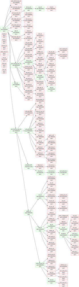

You may try the next intersting solution :
There are 2 ways to check the clock tree under linux BSP:
-  /unit_tests/dump-clocks.sh
- /unit_tests/dump-clocks-dot.sh
Copy the output to a file(imx6q_clk.dot) then use the dot command from graphviz to generate the picture:
1,721 Views
tom1
The png is unreadable.  I can save it but a lot of detail has been lost.  However, I will try to get this info off the SABRE board.
