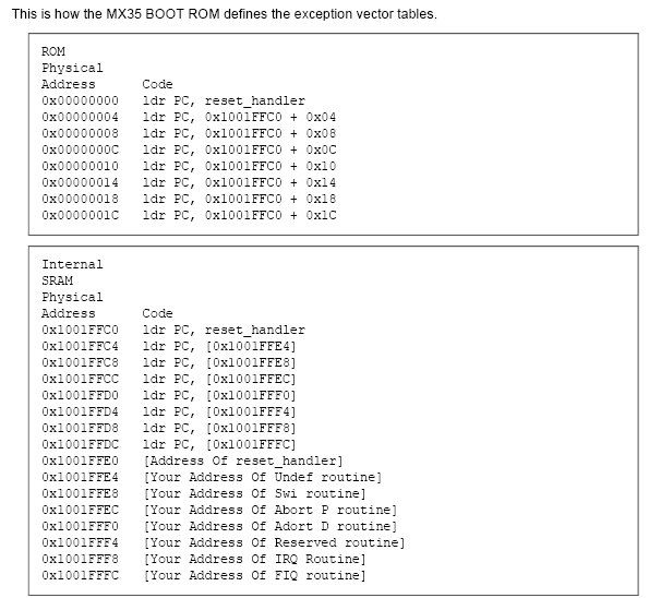

I am using Imx6q. Currently i have placed my vector table in the IRAM, from location starting from 0x0093ff80. Can i change the vector base address register to place the vector table in the DDR from the location staring from 0x10000000? Is it possible? Or is it necessary to place it in the IRAM itself? please Help..

Hi ajmalali
seems it is possible, for example below i.MX35 rom description,
i.MX6 processes in similar way
