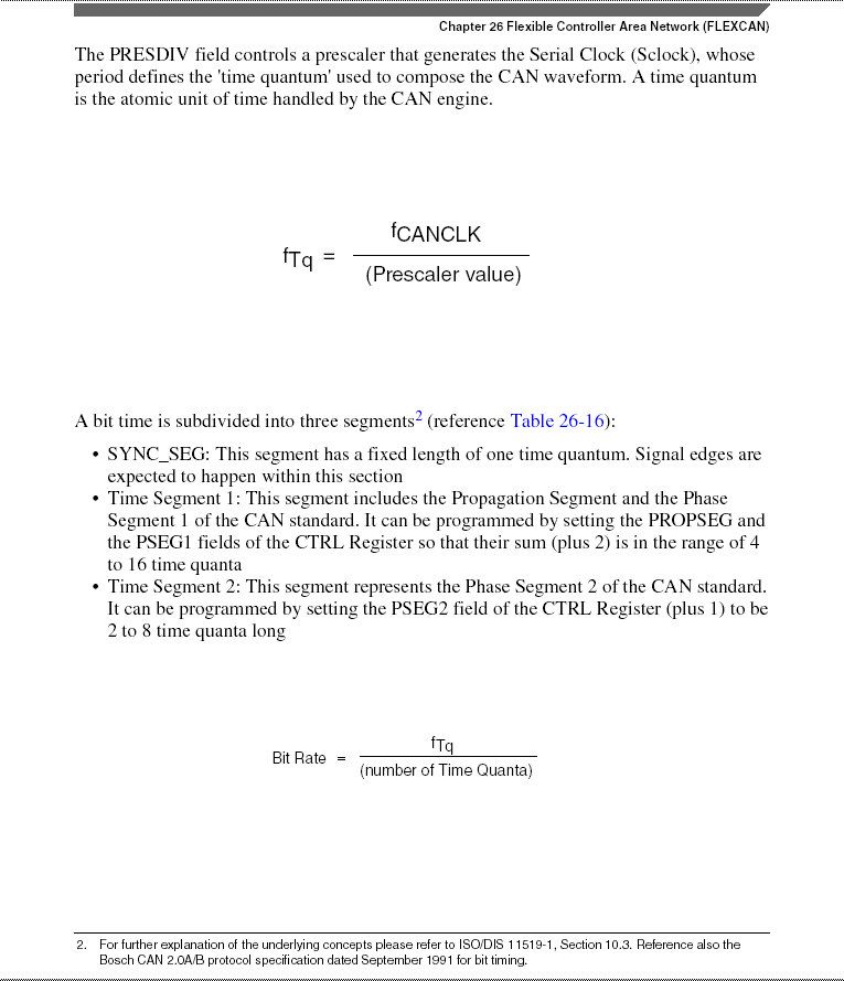

Hi all,
we have here equipment with CAN interface that needs a birate of 100000. The controller is a i.MX6Q. Can someone please help how to setup for 100kBbit/s? According to docs, I found only examples for 125kBit/s.
We can test with a Linux, but eventually the application will run under QNX OS, so I must understand how clocks and registers must be configured to achieve the effect. Many thanks.
-Albrecht

Hi Albrecht
you can look at SDK can example and document
iMX6_Firmware_Guide.pdf included to it. For 100Kbit/s one can add
next codes to function can_update_bitrate()  file can.c
i.MX 6Series Platform SDK : Bare-metal SDK for the i.MX 6 series
        case KBPS_100:
            presdiv = 11; // sets sclk ftq to 30/12=2.5 MHz = PEclk/12
            ts = time_segments[17]; // 25 time quanta (25-8=17 for array ID)
            break;
IMX6DQRM p.1315 explains
igor

albrechtuhlmann
Thank you for your quick answer, it works for us!
