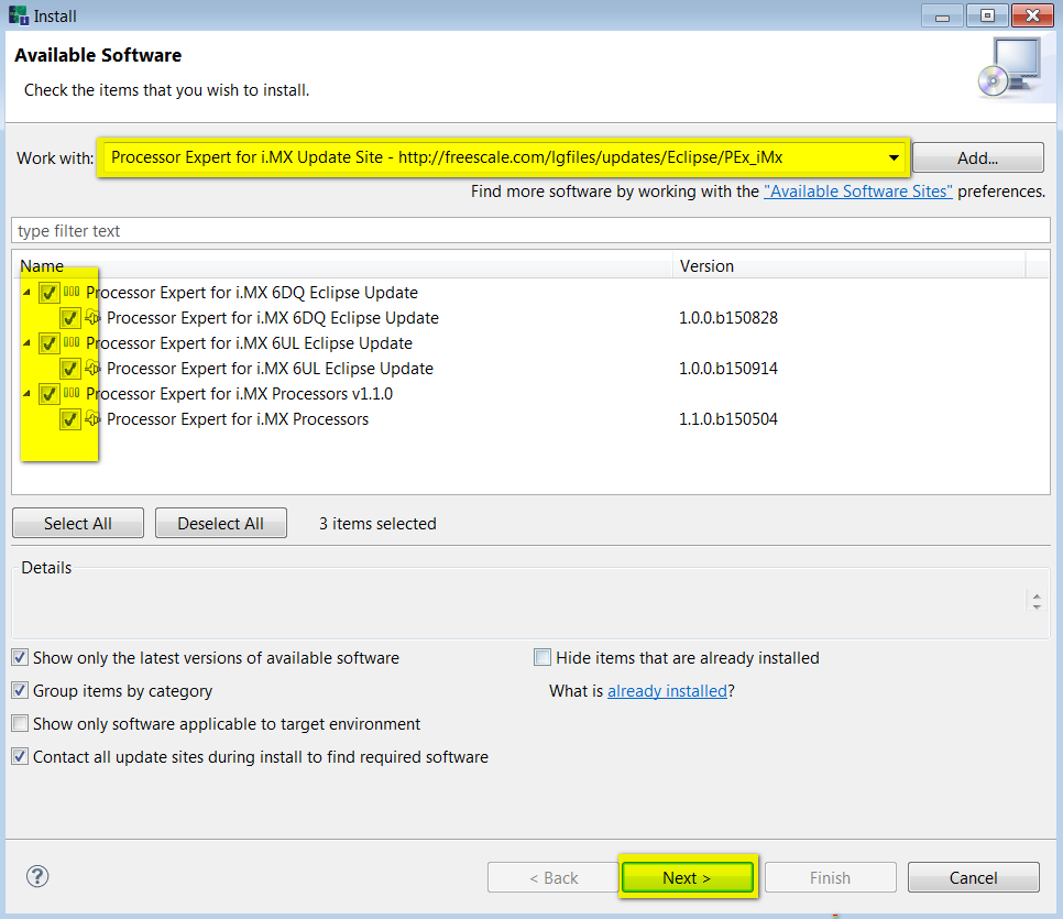

You have to install Processor Expert for i.MX:
http://www.nxp.com/products/software-and-tools/software-development-tools/processor-expert-and-embed...
Then apply the patches, Help -> Install New Software… ->
Select the Update website and select the patches to install.
Luis
