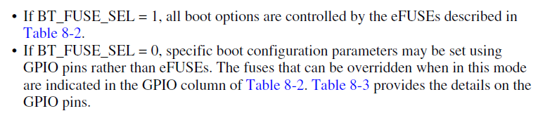

Hello Pratham,
do you have BT_FUSE_SEL set to 0? If not, then even in internal boot, the boot configuration is read only from eFuses, not from GPIOs.
Jan
2,217 次查看
prathamrahate
Hi Jan,
currently BT_FUSE_SEL = 0, so it is reading boot configuration from GPIOs.
Here are the SBMR1 and  SBMR2 values
SBMR1= 0xf7005040
SBMR2=0x12000001
Prathamesh
2,217 次查看
jan_spurek
SMBR2 looks fine - the same as for the Sabre SD board. However SBMR1 may be configured incorrectly. The value for the Sabre SD board is 0x1040 - BOOT_CFG4 is configured differently (mostly regarding the recovery boot device). Some of the settings are board specific - please check if there are no issues. I think that the probable cause is that Infinite loop is activated. If your board is based on Sabre SD and you didn't make any changes in this area, the same register value should work.
