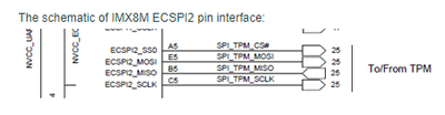

We are interfacing TPM2.0 SLB9670 with the IMX8M processor using SPI communication as shown in below schematic.

We faced a problem quite similar some months ago. It turns out that the SPI kernel driver doesn't work as expected. The problem is that the iMX8 SPI HW module pulls up the CS signal as soon as no data remains in the output buffer and this, puts the slave ( SLB9670 ) in a non selected mode, thus no communication is possible.
We solved the problem changing the CS signal used by the driver
Change your dts from this:
pinctrl-0 = <&pinctrl_ecspi2>;
cs-gpios = GP_ECSPI2_CS0;
to this:
pinctrl-0 = <&pinctrl_ecspi3 &pinctrl_ecspi3_cs>;
cs-gpios = <&gpio5 1 GPIO_ACTIVE_LOW>,
To sum up:
- Use a spare pin of your iMX8 to control de CS of the SLB9670. Letting the SPI kernel driver to do it is a bad idea.

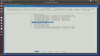

Is there a driver for SLB9670 in the kernel? Do you select it in the menuconfig?
9,712 Views
AlfTeleco
Yes there is, it is named "tpm_tis_spi".
You have to both select it in menuconfig and also place the device in the dtb.
