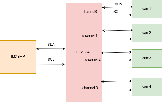

Hi all,
I am trying to integrate mipi camera(IMX219) to our IMX8MP custom board. I have to connect four IMX219 modules to iMX8MP. But it is having only 2 CSI interfaces, I'm doing it using an i2c MUX and two MIPI switches.
I'm able to get the stream from the CSI0 interface(both channel 1 and channel 2). But not with CSI1 interface (Channel 3 and channel 4). Getting the following error upon accessing the channel 3.
ERROR  : [MediaPipeline] NativeSensor open error!
ERROR  : [V4l2Event] initialize MediaPipeline error!
Following is the custom dts file that are using.

Attaching the dtsi file for reference.
Does it require any change to enable the second MIPI CSI interface?
Any help is appreciated.

2,326 Views
joanxie
how do you connect dual camera to the imx8mp board? could you share the connection of your application?
2,317 Views
Amal_Antony3331
Hi @joanxie
I have a requirement to connect a total of 4 cameras to CSI0 and CSI1. ie 2 channels to CSI0 and 2 channels to CSI1. I'm planning to achieve it through an i2c MUX and 2 MIPI switches.
Now I'm able to stream  all the channels separately. ( this is achieved by commenting out all other interfaces in dts file). Now I have to enable all the channels in the dts file. How can I achieve this?
Attaching the dts file for reference.(its extension is changed as dts file cannot be uploaded)
Charles
2,302 Views
joanxie
could you share the logfile? and what bsp version do you use?
