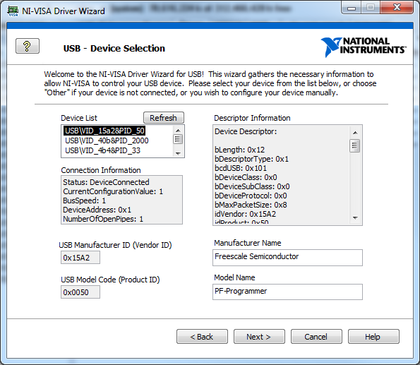

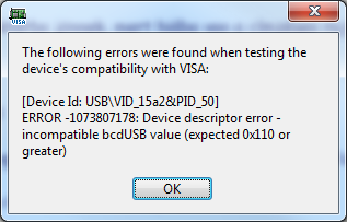

I recently ordered a KITPFPGMEVME programmer for MMPF0100 PMIC. The quick start guide says to download the drivers from freescale's website, but the download section has only links for the gui.
Has anyone the link for the NI-VISA 5.1.2 Communication package? I tried to acquire it, but I had no luck. I foud NI-VISA 5.4.1 and 14.01, installed both (separately), but they both gave the same error when I tried to create a NI-VISA driver. The error says:
The correct device is selected, as you can see:
I'm using W7 x64.
Thank you!
István

Hi Istvan Bosznai,
First and just to make sure, I’m assuming that you are using the KITPFPGMEVME REV B (KITPFPGMEVME should have a sticker on the bottom with “REV B” on it), please correct me if I’m wrong.
An important notice is that you will not be able to work correctly with the GUI 4.0 until you have the KITPFPGMEVME connected to the target board, however, the programmer should be detected when connected.
Now, I would recommend you to download the latest revision of the KITPFGUI_4.1 (REV 4.1.0.6) from the following link and test with this revision of the GUI: http://www.freescale.com/webapp/sps/site/prod_summary.jsp?code=KITPFPGMEVME&fpsp=1&tab=Design_Tools_...
With this version of the GUI (4…), the NI-VISA software is no longer needed, so you should not have this issue anymore.
You can find the Use Guide for this version of the GUI on the following link: http://cache.freescale.com/files/analog/doc/user_guide/KTPFSWUG4.pdf
And additionally the KITPFPGMEVME Rev B Programmer User Guide in the following link: http://cache.freescale.com/files/analog/doc/user_guide/KTPFPGHWUG.pdf
