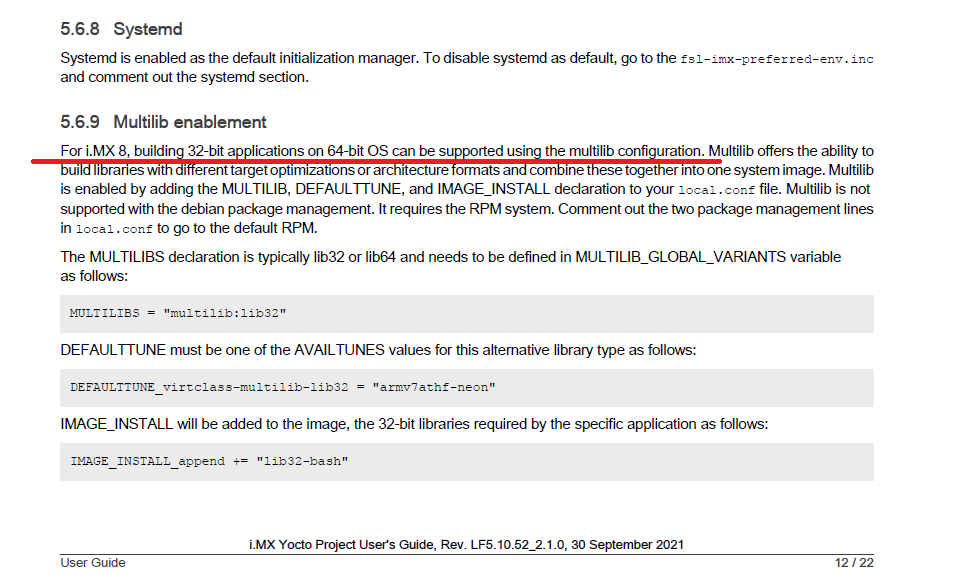

Identified that the board is aarch64. Our application is 32 bit. Is there any way to run the application on the board ?

If you use NXP BSP release, which is by Yocto, BSP document i.MX Yocto Project User's Guide gives guide and this guide is copied from Yocto document.

may be useful AN12212 Software Solutions for Migration Guide from Aarch32 to Aarch64
