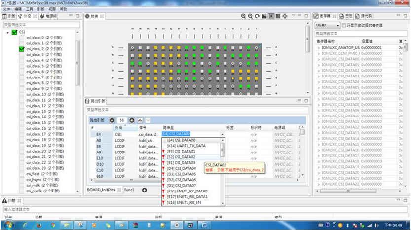

Below are they operate a error about planing camera IO pad define by using i.MX  IOMUX tools.

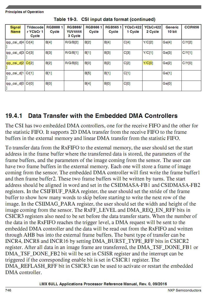

They select CSI_DATA02 to connect camera Y/C[0], but  show CSI_DATA00 (red word is can't use CSI_DATA02)
i.MX6ULLRM.pdf page 746 define T/C[0] is CSI_DATA02.

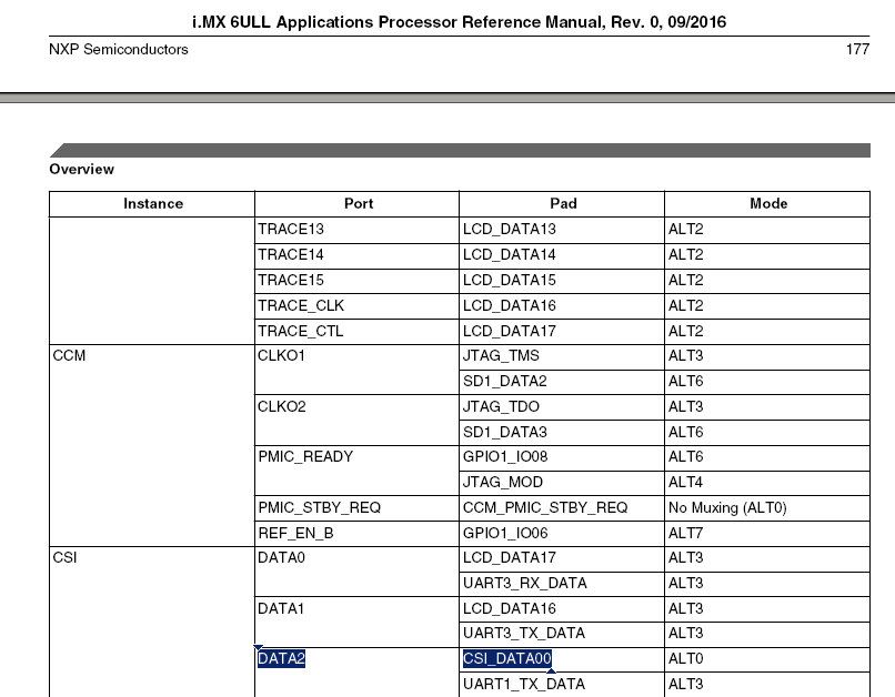

seems there is confusion between port name (ipp_csi_d[2]) and pad name - CSI_DATA00,
so for Y/C[0] (signal name DATA2/ipp_csi_d[2])  CSI_DATA00 pad should be selected, as described in RM p.178
