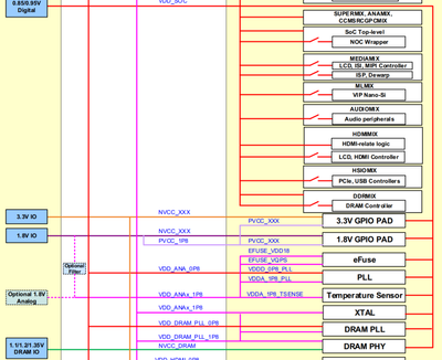

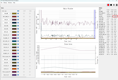

This is test result with pmt tool on i.MX8MP PWR EVK, the VDD_SOC already more than 900mA.
You can use lower core frequency, shutdown other MIX units and unless PLLs, the current draw could less than 900mA. You can test on this board: https://www.nxp.com/design/design-center/development-boards-and-designs/i-mx-evaluation-and-developm...
