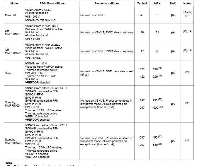

is it necessary to connect decoupling capacitors on the inputs of the PMIC if the corresponding outputs are not used?
E.g. if I don't use the SW1A buck converter, do I have to put a decoupling capacitor at SW1AIN?
And if yes, do I have to connect it to a voltage rail or can it let be floating?
The same applies to unused LDOs (VGENs) and VINREFDDR and VHALF. What should I do with the inputs and outputs if they are not used?
Thank you very much in advance.

Here you have some answers to some of your questions.
2. This is the current consumption of the MMPF0100.
3. We only recommend you to use the capacitors on the pins that we specify in the document.
4. This is defined on the power-up sequence of the MMPF0100.
