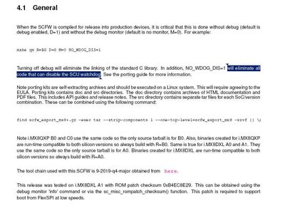

igorpadykov
Hi Tracy
part of SCFW is provided as binaries (not all SCFW is available in sources), also please look at
below Release Notes(sc_fw_rn.pdf) p.1 from  SCFW Porting Kit​ 1.9.0
igor
