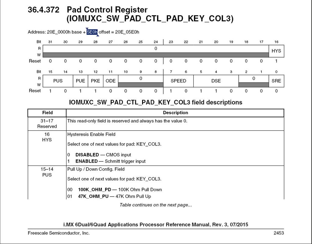

we used linux kernel 3.14.28 .In kernel dts file imx6qdl-sabresd.dtsi file .
How to configure new gpio pin by using dts file .
MX6QDL_PAD_KEY_COL3__HDMI_TX_DDC_SCL 0x4001b8b1
how to set the address can you any body please explain me.

addresses are set in ..arch/arm/boot/dts/imx6q-pinfunc.h

Thanks for your reply .but In that file how can i calculate reg address .please can you explain one example .

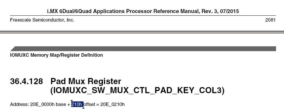

igorpadykov
#define MX6QDL_PAD_KEY_COL3__HDMI_TX_DDC_SCL
0x210 0x5e0 0x890 0x2 0x1

Thanks for your reply and explanation than input_reg,mux mode,input value how can i find out values .please can you give the explanation.
