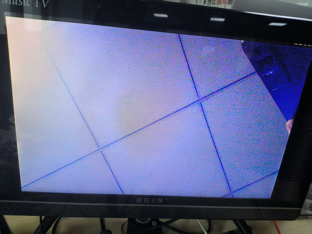

Use the command to preview, see the attachment for the effect and device tree.
The preview effect is not ideal. Can it be improved?

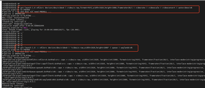

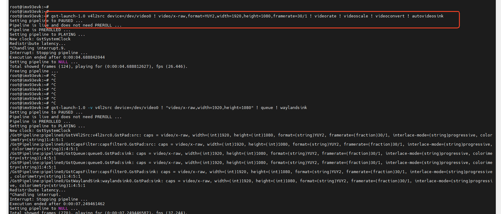

did you try the lower resolution? is it better, how about tying the command "gst-launch-1.0 v4l2src ! video/x-raw,width=1920,height=1080 ! waylandsink"?

Used this command:gst-launch-1.0 -v v4l2src device=/dev/video0 ! "video/x-raw,width=1920,height=1080" ! queue ! waylandsink
The effect is the same.Reduce the resolution, the effect will be better.

you can try to use v4l2 to capture one picture to check if the performance, if this is good, it seems this is related to your display side, this isn't imx93 issue, imx93 HW can support 1080p@30
