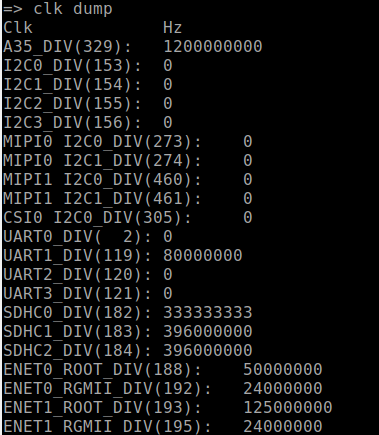

clk shows that it has been configured correcly

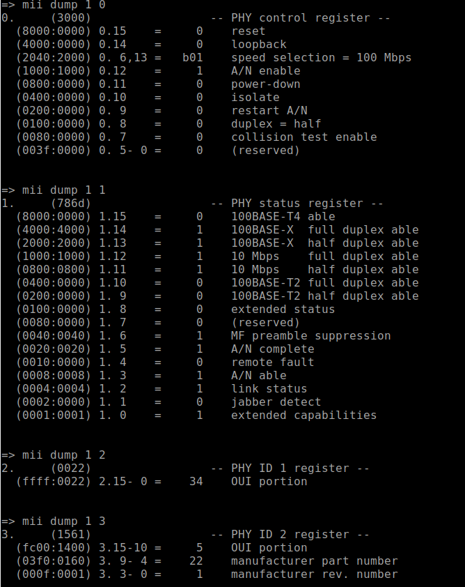

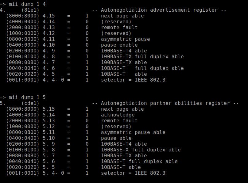

Mii dump shows all the configuration correct
