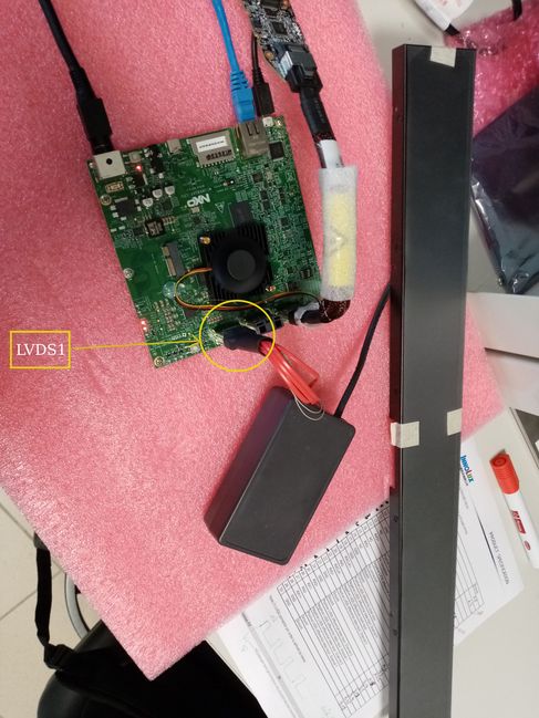

We are using custom board of iMX8QXP-mek
I built an NXP i.MX Release Distro 5.4-zeus imx8qxpc0mek image.
The board boot on SD card without problem
I have the display on hdmi screen using the IMX-LVDS-HDMI converter.
My goal is to have the display on an LVDS screen directly.
So I will not use the IMX-LVDS-HDMI converter.
My question is what do I have to change to have a display on a lvds screen?

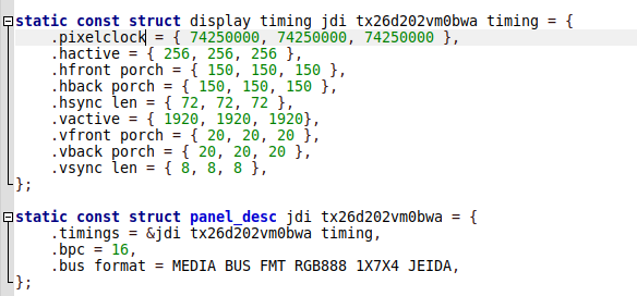

one can look at jdi panel dts:
https://source.codeaurora.org/external/imx/linux-imx/tree/arch/arm64/boot/dts/freescale/imx8qxp-mek-...
h=imx_5.4.70_2.3.0
timings can be adjusted in struct display_timing jdi_tx26d202vm0bwa_timing in driver
https://source.codeaurora.org/external/imx/linux-imx/tree/drivers/gpu/drm/panel/panel-simple.c?h=imx...

Hi igor,
Thank you for your reply !
I work with a S231AJ1-LE1-INNOLUX screen which is connected to mini SAS connector (J3).
I made changes in jdi_tx26d202vm0bwa_timing struct panel-simple.c to adjust the timing of the display:
After generating and flashing the new image, i used the dtb which exists by default to manage the display via lvds (imx8qxp-mek-jdi-wuxga-lvds1-panel-rpmsg.dtb)
=> setenv fdt_file imx8qxp-mek-jdi-wuxga-lvds1-panel-rpmsg.dtb
=> saveenv
=> boot
The board boot, but I don't have display in the lvds screen.
Knowing that for another project based on an imx6 card, I manage to have display on the same LVDS screen with this configuration:

I wanted to know if the settings I changed in the panel struct are the right ones to have the display working on this screen?
If not, what should be changed?
Is there a way to know if the new timing values ​​are taken into account?
