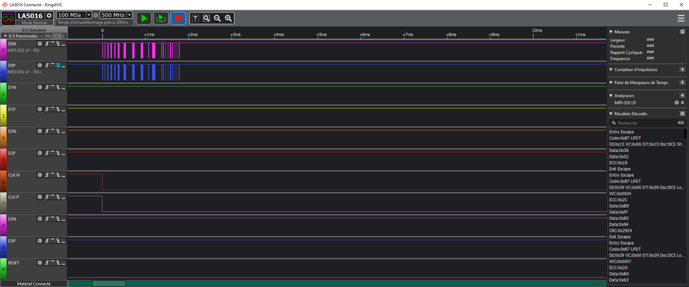

Using a MIPI analyzer (LA5076 and oscilloscope) I'm able to check that the driver ; HX8394, was correctly scheduled and the right behavior during the init phase (during the LP mode) :
By switching to the ST7703, I'm not able to catch the init sequence in output (using the same analyzer as previoulsy).

Thank you very much for your help, by changing the following lines :
static const struct st7703_panel_desc xbd599_desc = {
        .mode = &xbd599_mode,
        .lanes = 4,
        .mode_flags = MIPI_DSI_MODE_VIDEO | MIPI_DSI_MODE_VIDEO_SYNC_PULSE | MIPI_DSI_MODE_LPM,
        .format = MIPI_DSI_FMT_RGB888,
        .init_sequence = xbd599_init_sequence,

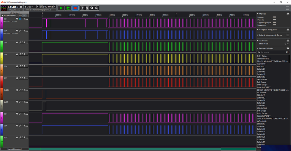

Adding the flag MIPI_DSI_MODE_LPM, I'm able now to see the init sequence, below a screenshot from the power-up :
One thing that remains strange : I am not able to see the clock...
Any idea ?
5,301 次查看
Tang_
To keep you updated
I finaly found where was my issue, the analyzer had a wrong setting and had a too high threshold during the HS mode (lowest value compare to the LP mode)
I can now sample the signals even if I'm not able to detail the frame due to the bandwidth.

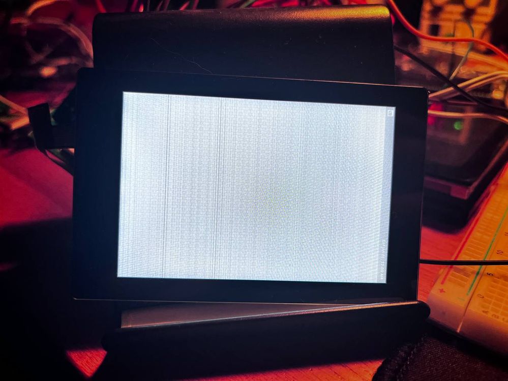

But for now I still have some lines, that you can see here, over the picture :
I guess it's coming from the timing setting as well, maybe the clock (in the drm_display_mode), but even by setting the following value I still have this issue :
clock = (H Total x V Total x 60) / 1000
Am I wrong with the clock value ? Or could it from somewhere else ?

After discussion with the TFT supplier, I made some tests using clock from 29998 until 40000 and higher, conclusion : and from 29998 until 39000 I have the result shown just before : desktop with horizontal lanes.
Using 40000, the TFT has a different behavior, the screen is blinking, the desktop is shown but with a lot of "perturbations".
From what I have the pixel clock should be 39998KHz ...
Any advices from your side ?
