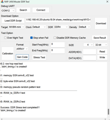

I am very glad to see your reply. I used imx config tool DDR configuration tool to configure according to the attachment "png" to pass the stress tests, and then replaced the timing.c file
uboot and file system display 4G, but the actual test failed, I think this may be because of the memory address and other gpu address conflict, can you tell me how to configure.

gongyaxuan
Thank you for your reply,
1. I have replaced the timing file, although the uboot shows 4G, the actual test failed
2. Do you just need to change timing? Do optee and ATF need to be modified? This is where I am confused

JorgeCas
Only timing and initialization files should be added to your build to use the selected values in DDR stress test to do the calibration.

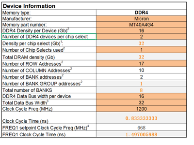

gongyaxuan
1. I configured the DDR according to the manual and created the timing file and replaced it. At this time, the board started normally and uboot only displayed 2G
2. There are two DDRS on the board hardware when I modify include/configs/myd_imx8mm.h as follows
