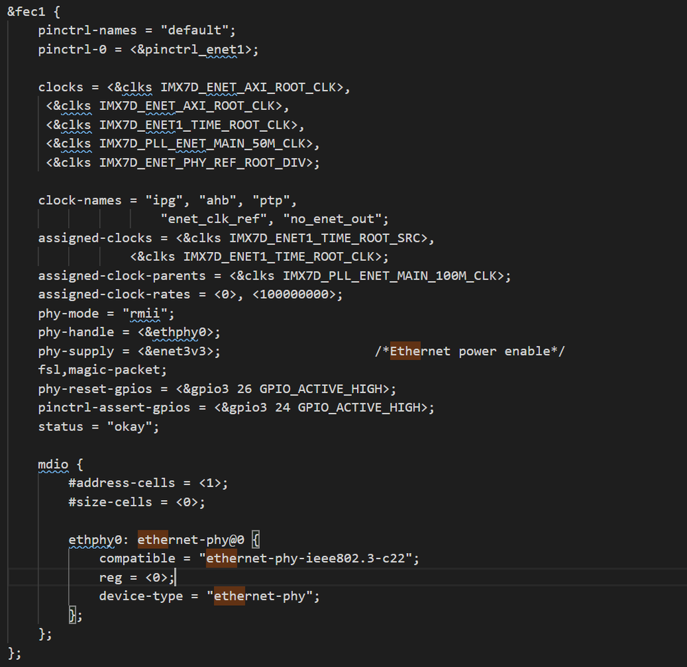

Hello All,
I am interfacing imx7d ethernet with DP83825 in RMII mode. My device tree setting is as follows:
I can connect to PHY but, after I check with the ethtool the link is not being detected. I get the following output.
Following the imx7d reference manual, the pin configuration was not clear for me in  RMII mode.
Is my pin setting for RMII is correct? Could somebody please confirm pin selection for RMII?

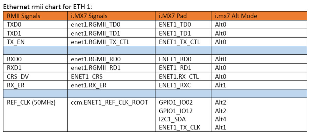

Looking at the above link
RMII interface on the IMX7
looks like pad MX7D_PAD_ENET1_CRS__ENET1_CRS  is not right for CRS_DV.
Our hardware engineer said, he is not able to select ENET1.RX_CTL for CRS_DV in Pin Tool for i.Mx.
Could you please confirm, if we can use MX7D_PAD_ENET1_CRS__ENET1_CRS for CRS_DV or not?

toradex colibiri board is using following device tree settings
pinctrl_enet1: enet1grp {
      fsl,pins = <
        MX7D_PAD_ENET1_CRS__GPIO7_IO14   0x14
        MX7D_PAD_ENET1_RGMII_RX_CTL__ENET1_RGMII_RX_CTL 0x73
        MX7D_PAD_ENET1_RGMII_RD0__ENET1_RGMII_RD0 0x73
 MX7D_PAD_ENET1_RGMII_RD1__ENET1_RGMII_RD1 0x73
 MX7D_PAD_ENET1_RGMII_RXC__ENET1_RX_ER  0x73
 MX7D_PAD_ENET1_RGMII_TX_CTL__ENET1_RGMII_TX_CTL 0x73
 MX7D_PAD_ENET1_RGMII_TD0__ENET1_RGMII_TD0 0x73
 MX7D_PAD_ENET1_RGMII_TD1__ENET1_RGMII_TD1 0x73
 MX7D_PAD_GPIO1_IO12__CCM_ENET_REF_CLK1  0x73
 MX7D_PAD_SD2_CD_B__ENET1_MDIO   0x3
 MX7D_PAD_SD2_WP__ENET1_MDC   0x3
So that means they are using ENET1.RX_CTL for CRS_DV and we have use ENET1_CRS for CRS_DV. which means we have used the wrong PAD. Is that right?
Could you now confirm that?
Asma
1,447 Views
igorpadykov
Hi Asma
right, actually for CRS_DV Table shows in "Pad" column ENET1.RX_CTL.
igor
